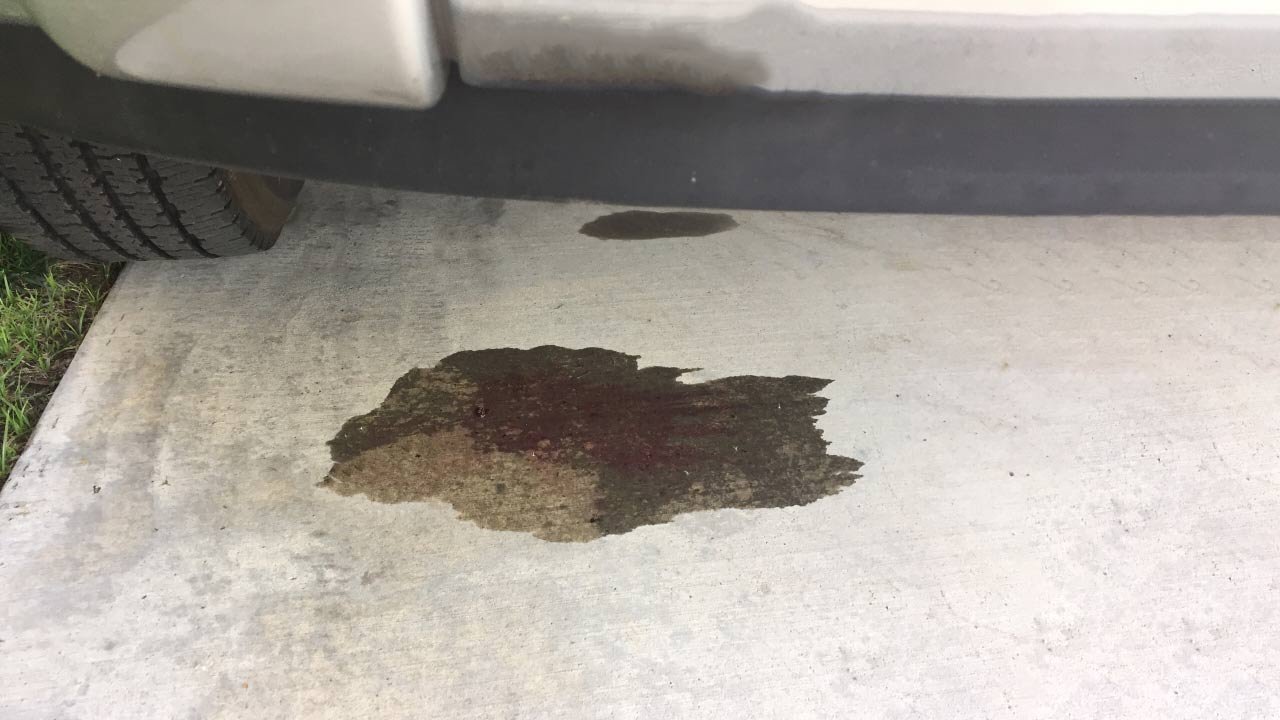

3. Transmission Fluid Leaks
Another common issue with the Ford Fusion is transmission fluid leaks. This happens due to a worn axle shaft seal within the PTU assembly.
The fluid can seep out around the seal as a result. Therefore, it’s crucial to check for any leaks from the axle shaft seal before purchasing a Fusion. Unfortunately, you cannot use any car hacks to resolve this issue.

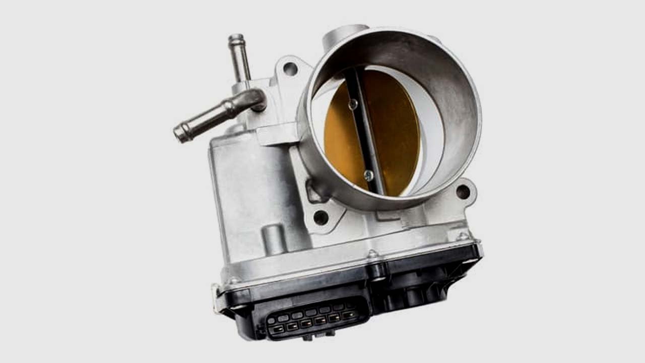

10. Throttle Body Failure
A faulty throttle body can be responsible for your car stalling, jerking, and hesitating while driving. The Ford Fusion models that have received the most complaints for throttle body failure are from 2010 through 2016.
The throttle body, which is a butterfly valve, is there to regulate air intake to the engine. You need to have enough air for the power to be generated.
In short, if your car is lacking power and having trouble accelerating, it might be time to replace your throttle body. This move will cost you up to $1,000.

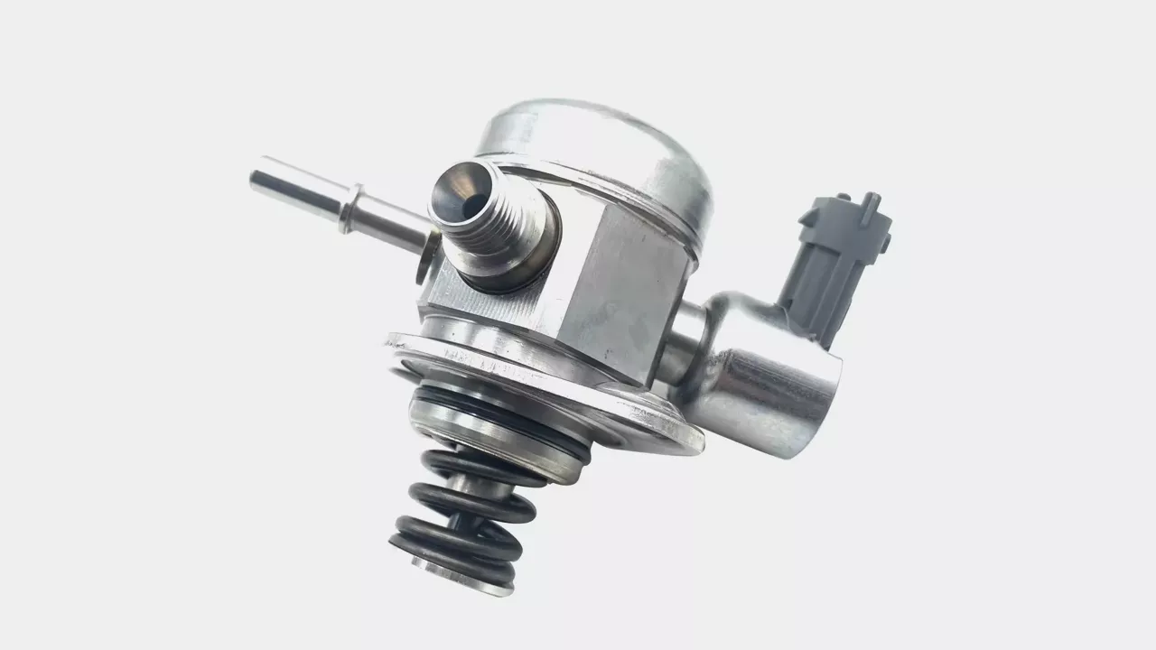

14. Fuel delivery or fuel-pump failures
There are also reports of Fusion fuel delivery issues leading to stalling and loss of power. The fuel pump or fuel module tends to break down and cease providing a continuous supply. Drivers experience a loss of power immediately when cruising. The engine may sputter or run rough at higher speeds and long cranks or hard no-starts are common. Another indication is a whining noise around the fuel tank.
There are complaints regarding certain second generation models, particularly 2013 and 2014, and these complaints are likely to be noticed after high miles. Here we face a safety risk with a failing pump stalling the car unexpectedly.
Repair costs vary. You have to dish out a few hundred dollars for a simple pump or module swap. Work on high-pressure systems and associated diagnostics may drive the bill into the low four figures. Occasionally, it is the sensor or wiring, not the pump that is the source of the problem and hence testing initially can save money.
Ford recently recalled a high number of vehicles in the US over fuel pump defect. Check VIN recall at NHTSA prior to your purchase. For surging, long cranks, or stalls, we advise getting a professional fuel-pressure test and a code scan right away.
