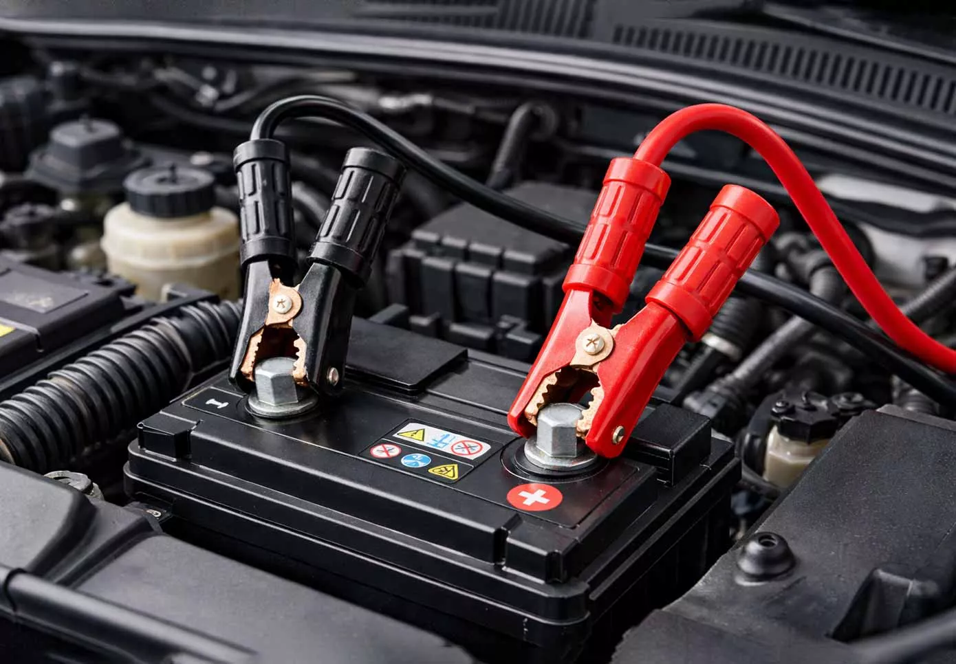

1. Choose a Good Pair of Jumper Cables
Ensure that the jumper cables are thick, well-insulated, and have clean metal clamps. Some cables may come with instructions on how to connect them correctly. The jumper cable should be in excellent condition and free of rust or damaged parts.
2. Locate the Battery Terminals
Open the hoods of both vehicles (the one that needs jump-starting and the other that assists it in ignition). Locate the black fuse box on Prius (behind the driver’s side headlight) and take out the cover to find the jump-start positive terminal (it must be corrosion-free). Some hybrid cars with hidden batteries have remote terminal posts for the positive (+) and negative (-) in the fuse box. Ensure the assisting vehicle’s battery rating is 12V, not anything below.
3. Closely Park the Assisting Vehicle Near Your Prius.
Always park both vehicles close to each other to make cable connections easily, but ensure they never touch each other. When connecting the jumper cables, make sure the metal ends do not dangle into the engine compartment. You must handle jumper cables with care. If you let them loose, they might scratch the car’s paint.
Make sure both cars are in the “Park” state with their ignitions disengaged.
4. Make Connections of the Positive Terminal
The central part of the process starts by making jumper cable connections for both cars. Connect the jumper cable’s positive terminal (red) to the dead battery’s positive terminal on Prius. After that, attach the other end to the positive terminal on the assisting vehicle. Ensure that no metal surfaces are in contact with the jumper cable’s negative (black) terminal.
5. Make Connections of Negative Terminal
Now attach one end of the jumper cable’s negative terminal to the negative terminal of the battery of the assisting vehicle. Connect the other negative end of the jumper cable to any non-painted metallic surface near the engine (a hood release hook is an excellent option). You can also consider using a remote negative terminal with a clear label. Alternatively, you can use an unpainted bolt or bracket near the dead battery to attach the negative terminal on Prius.
